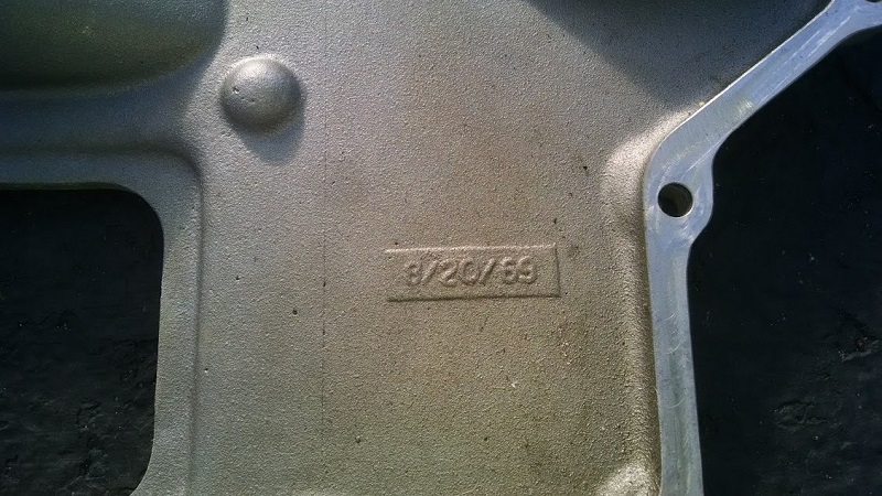

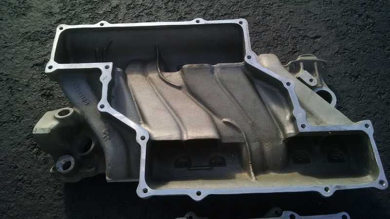

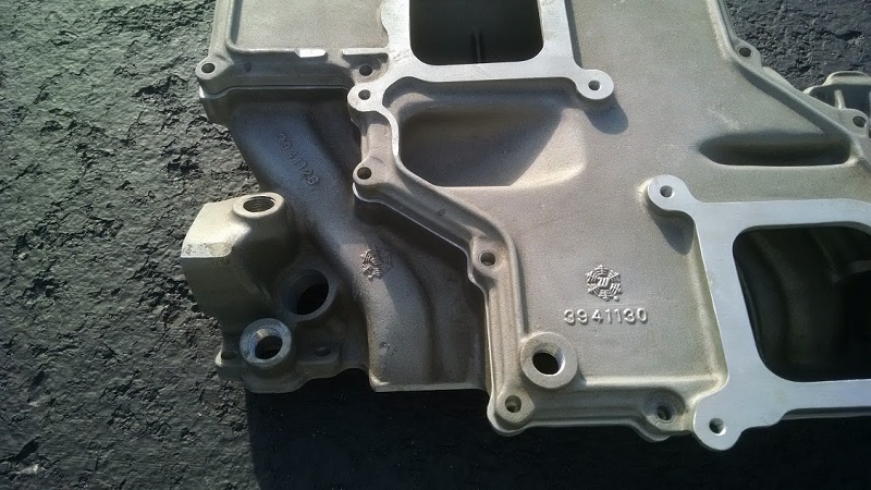

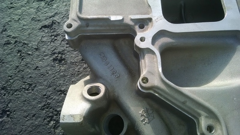

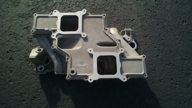

Reproduction 1969 Camaro Cross Ram ( Cross-Ram ) Intake Manifold. Cast numbers 3941130 ( Dated 10/1/69 ) and 3941126 ( Dated 8/20/69 ) All the bolt threads have been professionally chased out. Includes the metal gasket between the two halves. There was some professional machine work done to the top of the thermostat fixture and in front of the first carburetor mounting. Nicely done, don't know the purpose behind the work. Price is pending TBD 585-329-4655

Anyone else see anything?

Yes...sure do Jason.
Brad, sorry to inform you but that would be a genuine original "reproduction" intake. Base is not original, nor is the top.

I noticed that too but didn't want to say anything w/o others weighing in first.

Repros have old dates?! Yikes!

Nothing new,reproduction exhaust manifolds carry known 1967 dates too.

my buddy got burned on a repop too..paid full boat and was so excited..til he got it home.....
I thought this was a repop too...i just didnt think i should say something..i'm no expert by any means on anything cross ram..
