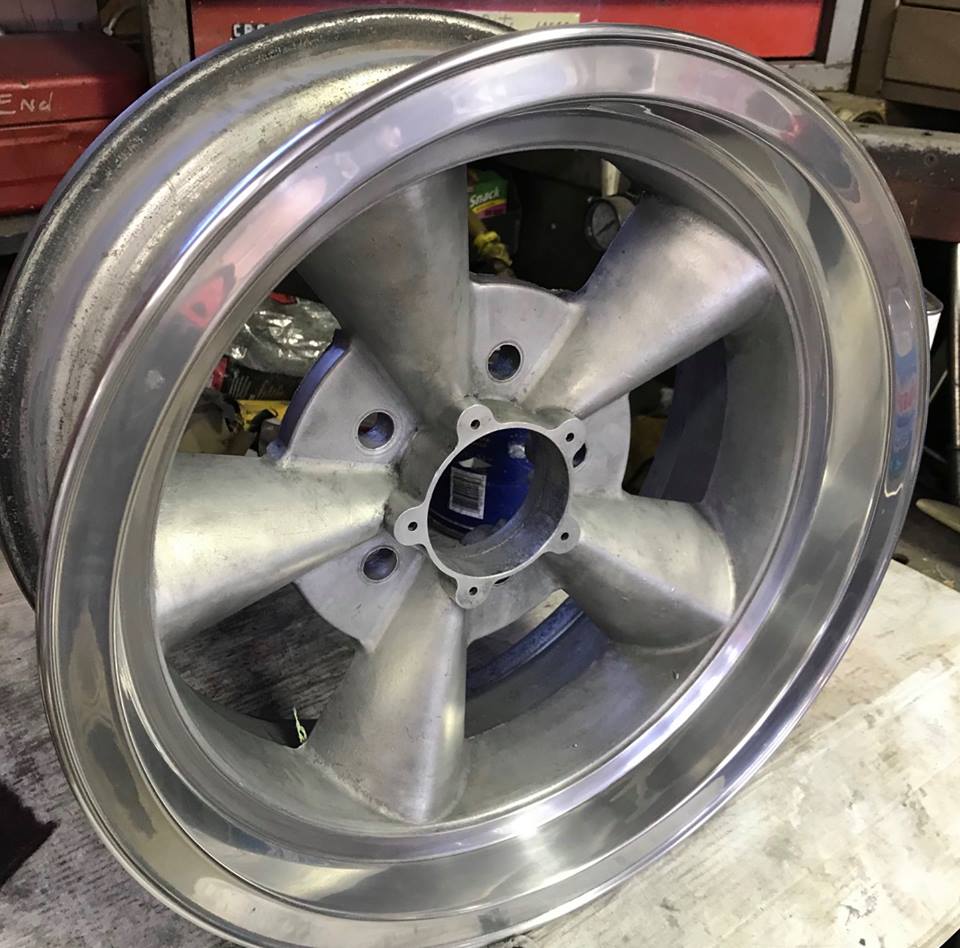

I have been working on restoring a set of 1960s Rocket RPM special wheels. Anyone have a NOS or really nice set of original center caps for these wheels? Or a good picture of what the center caps would have looked like. Here is my progress on one wheel after polishing the lip. Anyone have a paint suggestion for correct cast paint color for center. Has anyone ever used Martin Senour MS 7250 Iron Block Cast Paint on wheel spokes? Thanks.

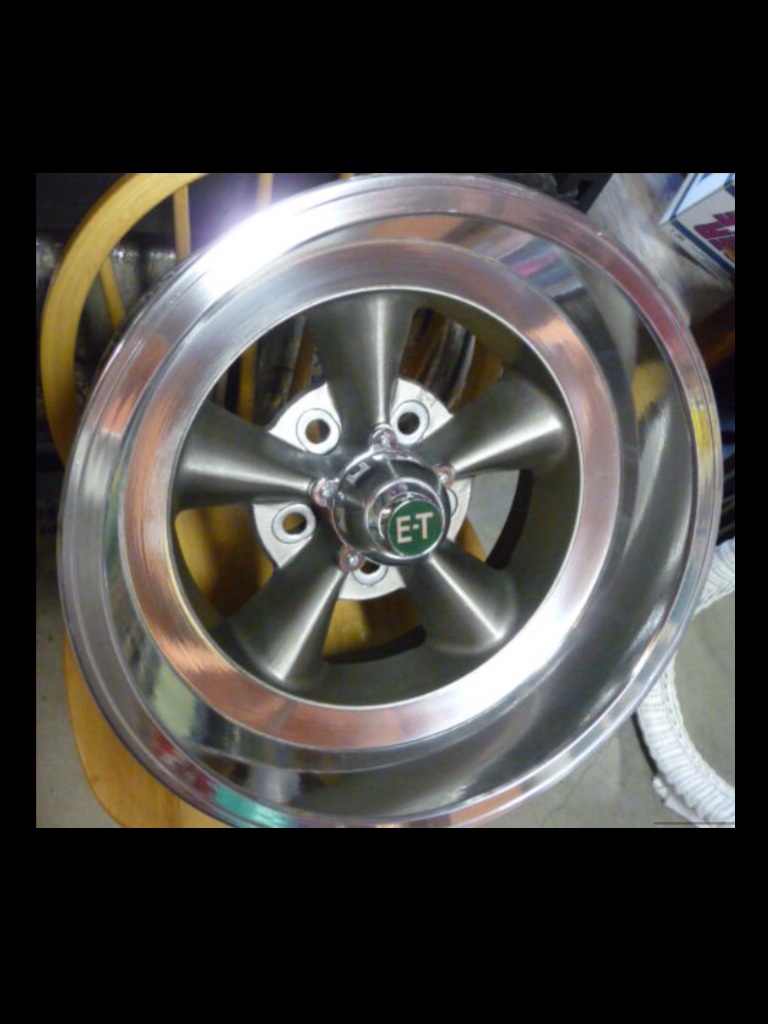

It looks like other Mfg's used the same Caps w/ different Centers as ET pic below, maybe you can find some and swap Centers?
Coker has a few Rocket Caps although none the same as you need, the page keeps changing but there's a similar Rocket Ctr. only around page 4-7 @ this link...
https://www.cokertire.com/accessories/caps.html#p=6
Other style 5-bolt tab Caps may fit too, I just checked the tab mount hole Ctr to Ctr dimensions of some Fenton Dish Caps here and got 2-1/8" between holes 1&2 also 3-7/16" between holes 1&3.

----On some original T/T's I have restored I used Long Island Corvettes 1965-66 knock-off wheel rattle can paint. Its a bit dark but I like the contrast with the polished rim......Bill S

I have lately been using Plastikote paint called "Steel Wheels". I'm pretty happy with it.

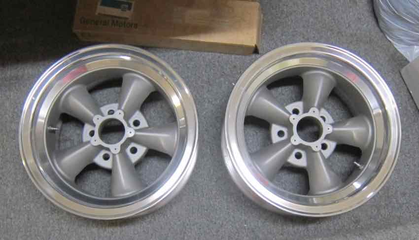

Just Finished restoring my wheels. I need to find a very nice original or NOS set of Rocket R.P.M Special center caps. These 15x6 wheels are goin to soon to be mated with a set of 670x15 Bf Goodrich Slivertown Blackwall tires. Anyone know of any of these center caps let me know. Thanks.

Look awesome, the fenton caps will do just fine until you find what you want.
