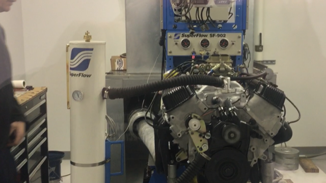

This block was split from stem to stern with numerous repairs unsuccessfully over a 20 year period before I got it. Also all the freeze pugs where welded. We machined and ground off 90% of the welds, on the out side of the block, the valley, the mains, the cam tunnel and between the cylinders etc. I then welded everything blended & textured the welds & installed new freeze plugs Pressure tested to 60 lbs. then line bored & lined honed the mains, bored & honed the cam tunnel .010 oversize, bored the alum. cylinders & installed new ductile sleeves & deck plate honed. Then assembled the engine with original & nos parts to 100% factory specs. I broke the engine in for 35 min. in Dec, 2017. The owner did not what to dyno full load because of its history.
All is well no leaks of any kind & excellent oil pressure.

Default Zl1
Crappy Pictures from phone video at first start up.
