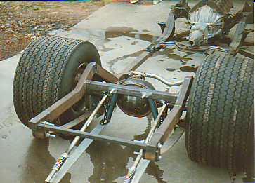

The next picture is the frame that I built at the age of 19. I had quit my job and was going to vocational school to be a welder. Most of the frame was built at school. This was the very first of many rear ends that I narrowed.

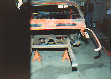

The car sat for many years due to a serious lack of money. After getting married, getting a real job as a DOD aircraft certified TIG welder at GE Aircraft Engines and buying a house and building a garage I was able to start on the car again. The reason that I decided to go Pro Street was because the car was full of rust and some after market parts were not yet available to fix it. This last picture shows the entire back end of the car removed.

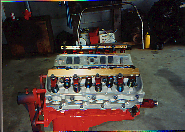

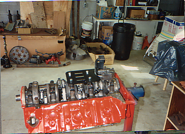

This is the first time the engine was assembled. The block is one of the first Bowtie blocks, the crank is from a L78, the rods are LS6 and the pistons are TRW.
The heads are 3rd design GM aluminum D ports. The cam was a Comp Cams solid roller, rockers are Comp Cams and the stud girdle is an old Jomar. The engine has been apart many times since then. This was the first of 4 cams that have been in the engine.

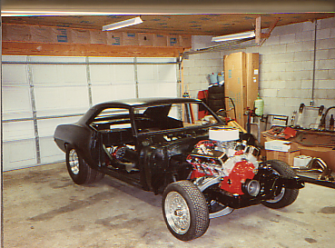

Things starting to come together. This is how I cut the new NOS GM quarters to fit the larger tires. In the late '80s these were still available and cost around $230 each.
I actually started off with a Predator carb, but quickly figured out that it wasn't going to work.
Roll bars and floor coming together. This was the first time that the car had rolled out of the garage on 4 wheels in many years.

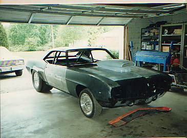

Even though the fenders, door skins and other parts were all NOS GM parts, they didn't fit perfect. It took a lot of work to get the seams right. The fenders didn't fit well at all and it took many hours to work out the problems. My brother helped me get everything fitting correctly.
I had originally wanted to use this pro stock style hood and a fiberglass trunk lid, but thankfully I changed my mind.
This is one of the body shops that the car was in before it finally got painted. I waited over 3 years for the first guy to do the car and I ended up getting the car out of his shop and taking it to this one. 18 months later it was painted. It was painted in '93. Tony Oglesby did a great job on the car and it still has this paint on it.

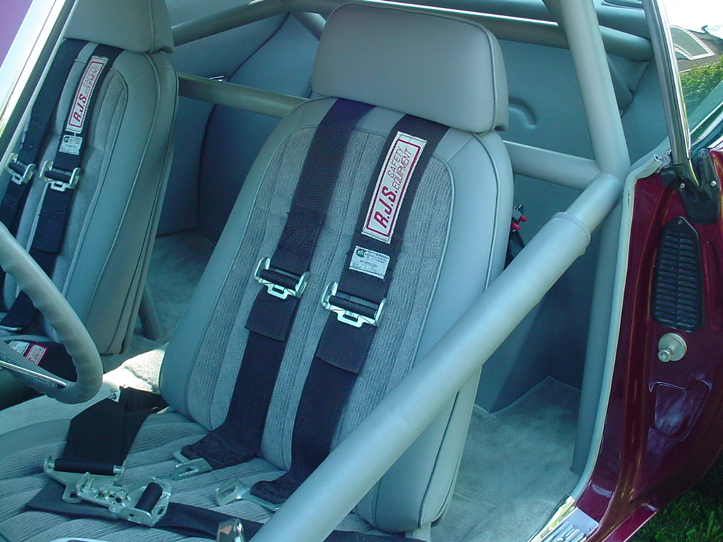

Interior finished. The Nova dash required several modifications. The steering column had to be raised, the dash frame had to be modified some and the Nova dash pad needed some modifications to smooth it out and make it fit. I used the Nova dash because I wasn't going to be able to put gauges in the Camaro dash and make them look the way I wanted them to look.

Early picture of the 427 with the Milodon valve covers, high mounted alternator, plug wires laying on the valve covers and the old MSD ignition. This was the 3rd of 4 MSD boxes that have been in the car. At this time it still had the original big block radiator in it.

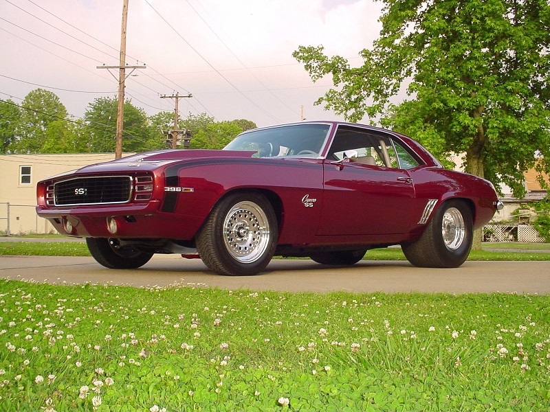

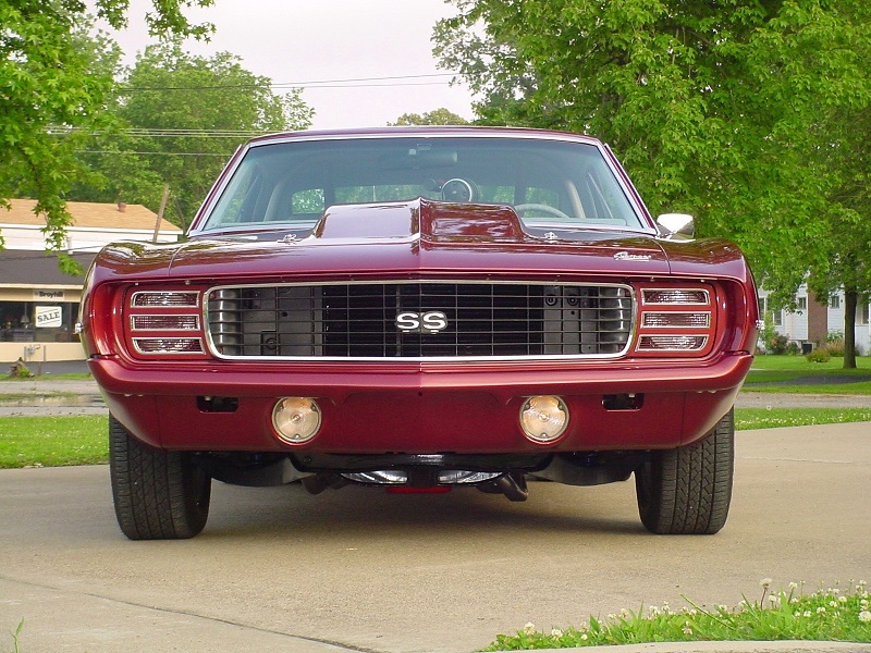

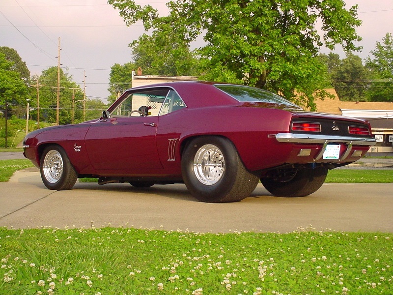

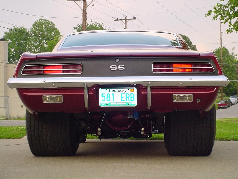

Some pictures of when I first started driving the car again. The Pro Stock Centerlines were some of the first that were made. They have 1986 dates on them. The rear wheels are 15X14 and the fronts are 16X7. This might be the only set of 16 inch Pro Stocks that were made. The Unlimited Fiberglass Products hood took a lot of work to make it look good.

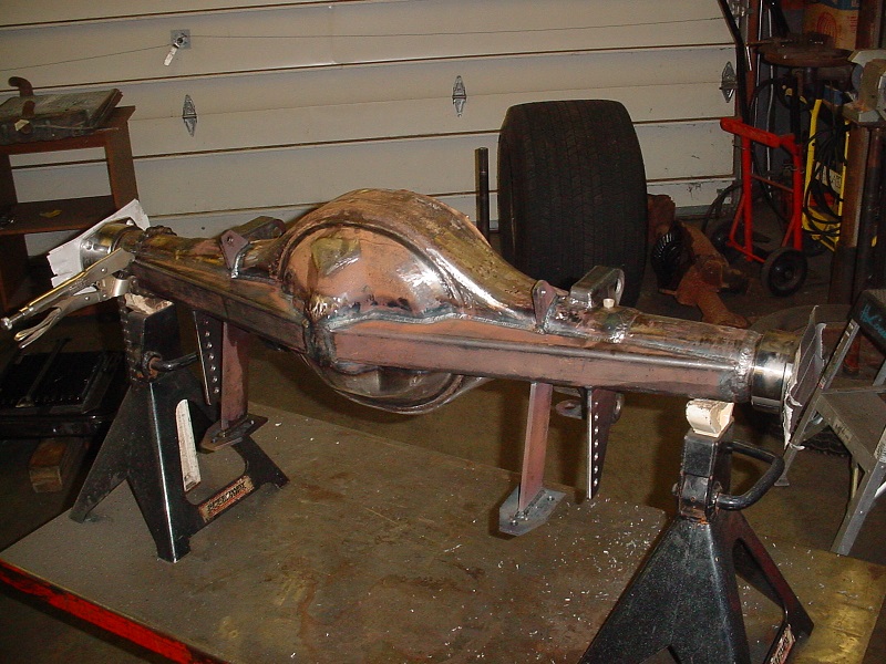

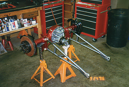

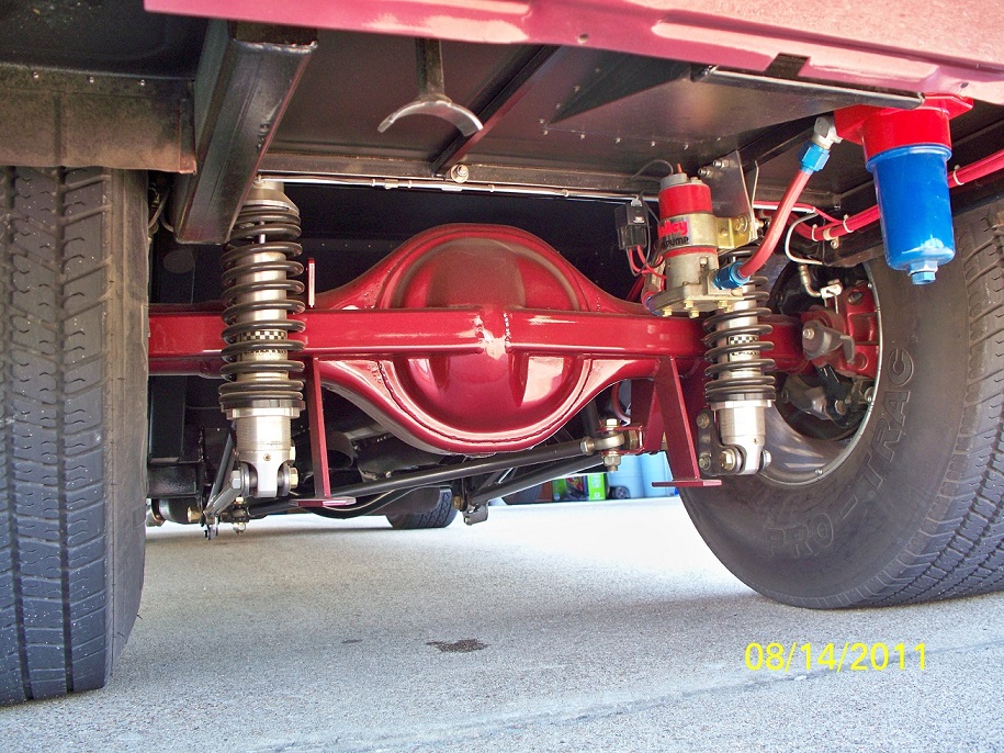

I decided to redo all of the rear suspension several years ago. I got rid of the leaf springs and installed a set of Varishock coil overs. The shocks in the picture are some old Chassis Engineering shocks that turned out to be no good. I made a new set of ladder bars and built a F150 9 inch housing. I made all new brackets and added a brace to the housing. I've got a set of wheelie bars for it, but I haven't put them on.
