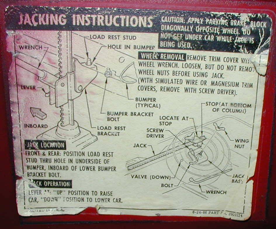

I believe the correct fastener for '69 is a large pan-head screw. It also had either a lock washer or captured external tooth star washer. I can check for sure on Sunday to be sure.
Incidentally, the gent that worked in the Baltimore factory told me that during the 69 production year, Chevrolet started including wooden-handled phillips screw drivers with the jack assembly so the customer could take off the SS cap with a tire change and be able to re-secure the wheel in the trunk. I don't know if all the factories did the same or not.

Bill, found this pic in my 69 chevelle assembly manual in the J52 RPO section, shows the SS wheel and cap. I modified it so the part numbers show in the pic here. It states a screw and the drawing looks like the one Woj posted a pic of. take care, Andy
