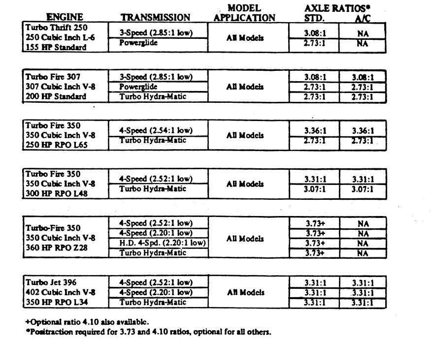

Out of an SS car as Z-28 would have 3.73 or 4.10. Could it be from a '70 Nova SS?

3:55 Open from 70 SS L-34......????

COW is 1970 model Camaro 3.55:1 open rear.
70 Camaro is slightly wider than 67-69. 70 Nove would be the same as 69 Camaro.

I thought the 3.55 was standard on the L78 cars. I'm sure most had the posi though.

<div class="ubbcode-block"><div class="ubbcode-header">Originally Posted By: Jeff H</div><div class="ubbcode-body">I thought the 3.55 was standard on the L78 cars. I'm sure most had the posi though. </div></div>
I think that makes sense...the 3.55 open rear would have been the 'default' unit for the L78...but, you had to order the posi-traction.
