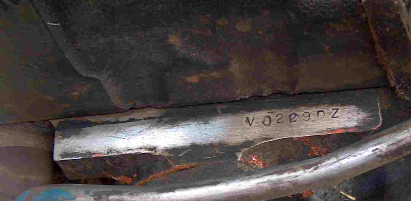

<div class="ubbcode-block"><div class="ubbcode-header">Originally Posted By: William</div><div class="ubbcode-body">The entire 1100837 37A stamp matches what I have.
If you were going to re-stamp one would you pick a date that 'wasn't known'? </div></div>
Well, he might not, but some of the guys restamping this stuff aren't always that smart.
Just as an example, below is one of the worst DZ block restamps of all time, especially considering 1969 was NOT leap year.
