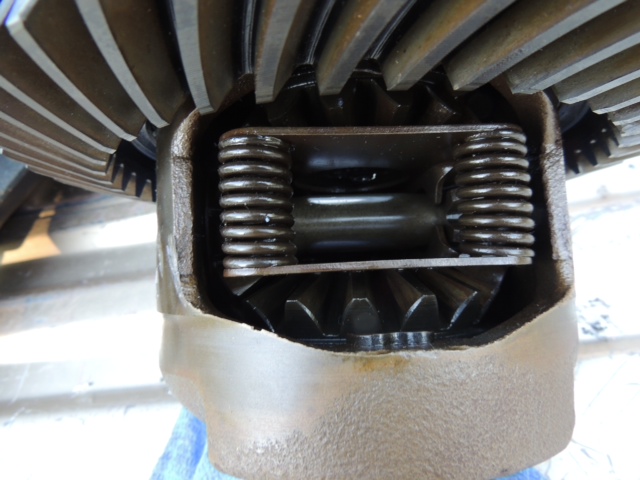

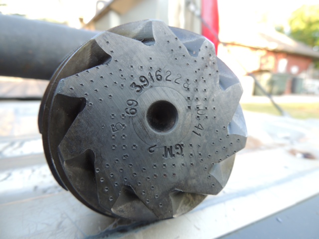

I believe there was a discussion on how to identify a copo heat treated 4 series carrier in a copo rear end... but I cannot find it...
...any help is appreciated... [img]<<GRAEMLIN_URL>>/beers.gif[/img]

John. The part number on the flange last 3 digits are 234

Regarding the &quot;heat treatment&quot; I believe that was only for the Ring and Pinion, not the carrier.
While the carrier was different and some special parts were used, I don't recall anything other than the Ring and Pinion getting anything special heat treatment wise.

&quot;BE&quot; 4.10 parts

For future searches, here are all the BE KQ goodies that allot of the BE's are lacking.
The carrier is a standard 4 series and is machined differently inside.
