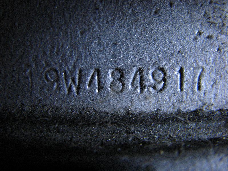

A friend of mine bought this 68 Chevelle recently and is having trouble with the 4-speed in it. Does he have to get it out of the car to determine which trans he has, M20,M21 or M22? He wants to find a replacement first and then take it into the shop.
Stamped on the trans he found: P8E23 and 18W348416
Any help is appreciated.
Anders Stålklint.

Muncie from a 1968 Nova. I don't believe you can tell M20/21/22 in '68 unless you pull the trans and count the grooves on the input shaft (2=M20, 1=M21, 0=M22)

M22 will have the drain plug...build date makes it a possible BB application. They didn't start using the A,B,C codes until fall of 68 [69 models]..Nova Muncie 4 speeds are rare...might have some value to a Nova guy looking for a dated part.

He didn´t get back to me right away. Apparently he did make the Verne-test and found out that it was a M-20. He has pulled the trans and is going on a 150 mile trip to a guy who knows Muncie´s inside and out, as we don´t know of any Muncie guys locally. I think he said that guy is around 75 now.

don't assume a drain plug confirms it's an M22, i've added drain plugs to a few M20-21s i had apart. [img]<<GRAEMLIN_URL>>/rolleyes.gif[/img]

Like this one......came to me in an LS6. Needless to say I replaced it with the correct part and bought this one for my inventory.
I should add, don't always assume that a trans is an M22 based on the drain plug and/or stampings. You can always put M20-M21 guts in an M22 case. Also, I believe starting in 1970 all Muncie 4 speed cases were drilled for drain plugs.

You could also pull the side cover if you don't want to pull the whole trans.
