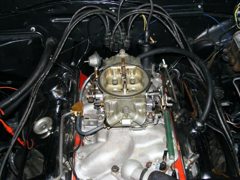

the original GM piece put on my car in 1972 has no base-to-valve cover tube so it wasn't an issue....
the re-pop (cuz I wanted the tube) has 'ever-so-slight' contact as seen by the mark here on the tube. I will have to give the tube a few hammer knocks to clear...

Tracker1;
Excellent pics, thanks.
Your carb appears to have a 30 c.c. pump on the rear, the 850 I'm using has a 50 c.c. pump which utilizes a significantly larger accelerator pump lever &amp; spring assembly. Short of mangling it, I'm not sure I'm going to get the base to fit at all.
