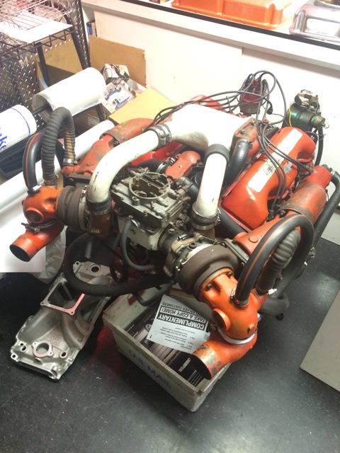

For added interest, here's a twin turbo version shipped to Daytona Marine.
