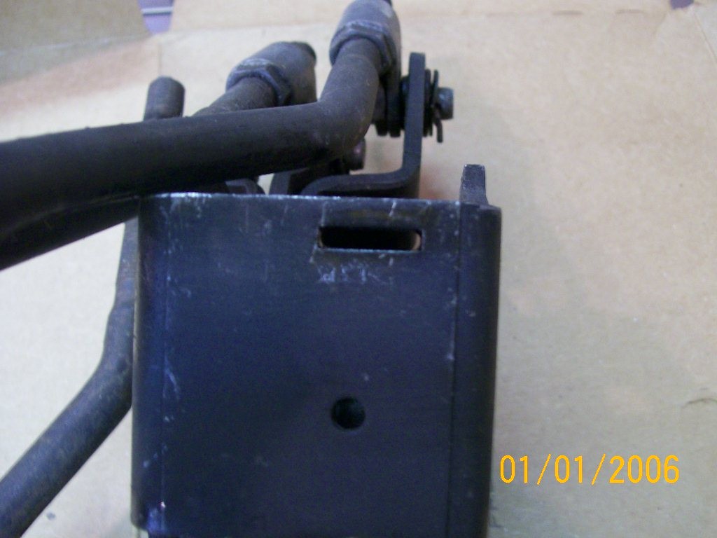

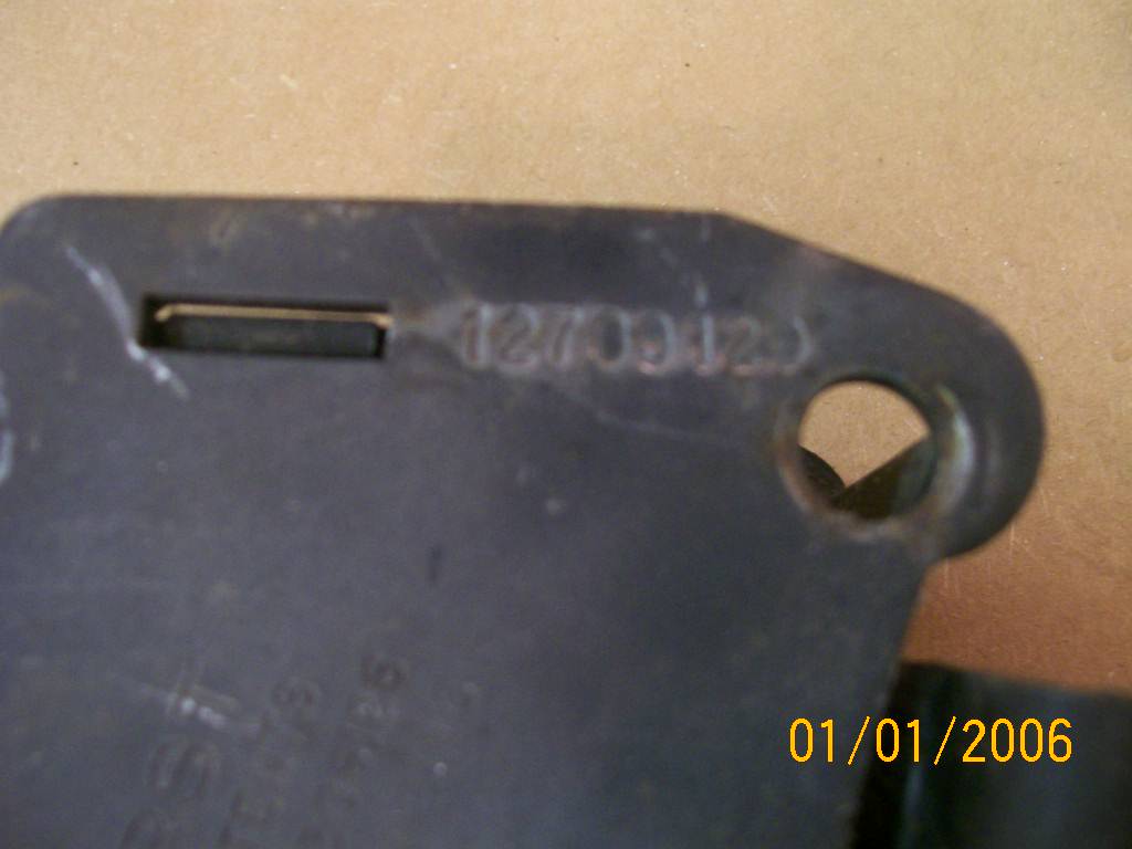

Assistance please. Need to confirm this shifter was pulled from one of the Z cars I owned in the past. Numbers are 1270912D on the side with 3138 on the front. Missing one of the shifter ears but I think I can find it. The 2 ears that are still intact have 6392 & 9067 stamped in them. Handle has light surface rust near the bottom whih would not be visible in the car due to the boot. What's a fair price for the unit? Thanks in advance.

That is a 70 and later Camaro/Firebird shifter. You would have to pull the handle to see the stamped number to know the specific application.

The above Hurst shifter is for 1975-79 F-body with a ST-10 4-speed...
