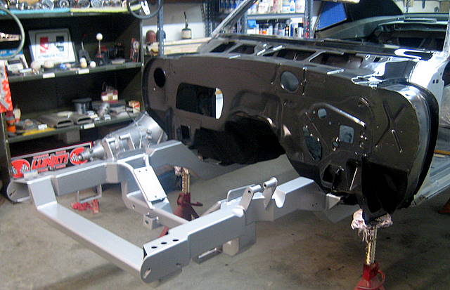

I'm just about finished with this car for a customer.
69 Camaro with a 540, Jerico 4-speed and Strange Engineering 9" rear.
Heidts 4-link, ( tried to get him to do Detroit Speed but he wouldn't go that route ), tube control arms, manual rack and pinion.
We replaced everything on this car except for the roof structure and the firewall and toe boards.
Detroit Speed frame connectors were added and the OEM style inner tubs were widened 3".
Car has alot of hidden mods that the average person won't pick up on.
He is going to make the car look sort of like the Penske Sunoco car , but for the street.

I made the transmission crossmember part of the chassis / floor so the exhaust could be placed higher into the car.
I used solid aluminum stock and machined the rack mounts so they could bolt to the crossmember.

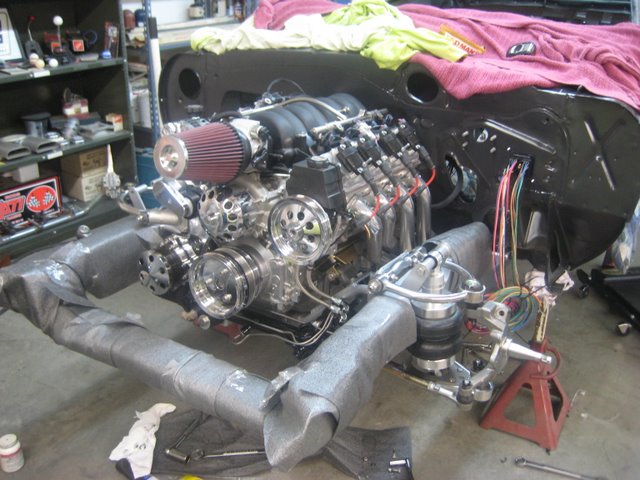

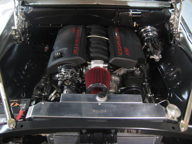

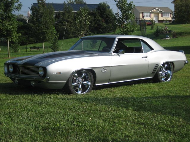

Here is one that you won't like..lol
Finished this car last year. It has a LS3 from Turnkey Engines.
Air Ride and all the modern goodies. I couldn't figure this guy
out. He had us take the car down completely and do the build,
but he refused to paint the car, other than the engine compartment. The body work and paint were
awful.
