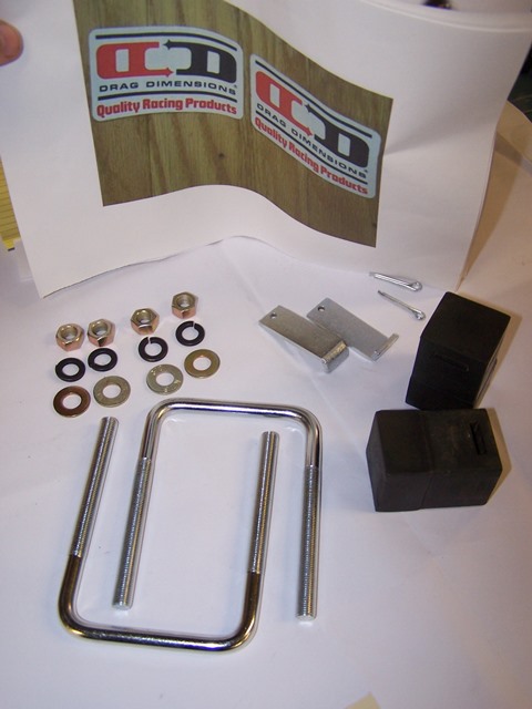

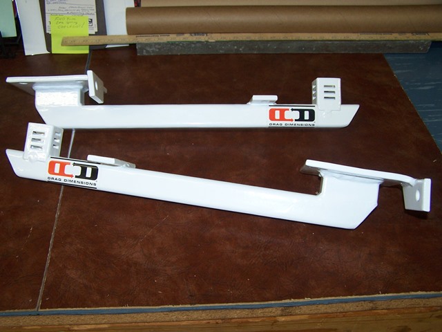

Does anyone have a set of the old-style Lakewood traction bars like Grumpy used to use? I need some measurements, like tube size, wall thickness, position of the lug the strap grabbed, etc.

I don't have a set, but would like to encourage you. I would just use a similar set of bars as a reference. Basically you just need to make it with a swuare tube, rather than a rectangular one. How authentic do you really need them to be if you are already improving/ altering them?
I've read you want to make the length longer to catch the spring eye. I think that is a great idea. They made them both with long tails and without. I would recommend you make the long tails. This will get you the ability to toss in a set of wheelie bars.

<div class="ubbcode-block"><div class="ubbcode-header">Originally Posted By: pxtx</div><div class="ubbcode-body">I don't have a set, but would like to encourage you. I would just use a similar set of bars as a reference. Basically you just need to make it with a swuare tube, rather than a rectangular one. How authentic do you really need them to be if you are already improving/ altering them?
I've read you want to make the length longer to catch the spring eye. I think that is a great idea. They made them both with long tails and without. I would recommend you make the long tails. This will get you the ability to toss in a set of wheelie bars.</div></div> Well, the most important measurement is the angle of the cut on the front of the bars. I can probably get the rest close enough by guess and by golly, but it'd give me a warm fuzzy feeling inside to know I have a set that are virtually identical except for total length.

<div class="ubbcode-block"><div class="ubbcode-header">Originally Posted By: pxtx</div><div class="ubbcode-body">They made them both with long tails and without. I would recommend you make the long tails. This will get you the ability to toss in a set of wheelie bars.</div></div>
Does anyone know if 6&quot; is long enough for the tails?

I would say that would work. Since you are making yours longer, use your best judgment on making them look balanced.

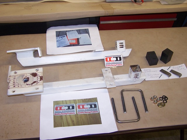

Here is a reference shot for the ones on ebay
Not mine here, but I do have a NOS set also. Mine are Yellow and they have some other plates that go in the inside of the car to sadnwich the sheetmental around the spring pocket.
