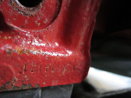

The trim tag shows the car as a 02D - 4th week of February car. The engine is stamped T0210JH - Feb 10th 396/375hp Manual Special High Performance and the vin is stamped by the oil filter. I have not gotten a chance to get the trans or rear stampings yet but will have them in a few days.

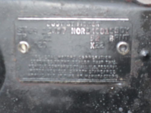

What are your opinions on the pad and vin stampings? I am attaching the trim tag as well showing it as a X22 garnet red w. 711 base interior. The tag appears to have good rivets and does not appear to have been removed.

I´m sure the experts here will chime in, but I would get ahold of Kurt S from CRG...or maybe he will chime in here...
I will say that the pad stamp sure looks well aged...and also that is the clearest vin stamp I have seen...most that I have seen are barely legible...
but I am no expert on these stampings...

I have a picture of an original L78 motor stamped seven days past this one. A Norwood car as well. On the one I have, the head must have been in place for them to stamp as you can see the angle it was stamped at.

I remember this car on ebay last month. Sorry, but I think it is a restamped block. [img]<<GRAEMLIN_URL>>/frown.gif[/img]
Axle could be the original (standard ratio was 3.55, but 3.31 is pretty common). Date is OK.
I'll reserve comment on that tag pic.
<div class="ubbcode-block"><div class="ubbcode-header">Originally Posted By: David C.</div><div class="ubbcode-body">On the one I have, the head must have been in place for them to stamp as you can see the angle it was stamped at. </div></div>Actually, all BB's were stamped before the head is installed. That's why some BB stamps are partly under the head.

-----A picture of the pad with just a bit of cleaning so as to try to judge the broach marks would help. Nothing too abrasive. Id have to say that things look OK so far, though......Bill S

I will see if I can clean up the pad or even get the head off and take a few more pics. The pad I feel pretty confident about - the vin stamping does look rather deep to me. I does show the typical varying depth where the lower portion the stamping is not as deep as the top but I am still suspect that it appears too deep.
