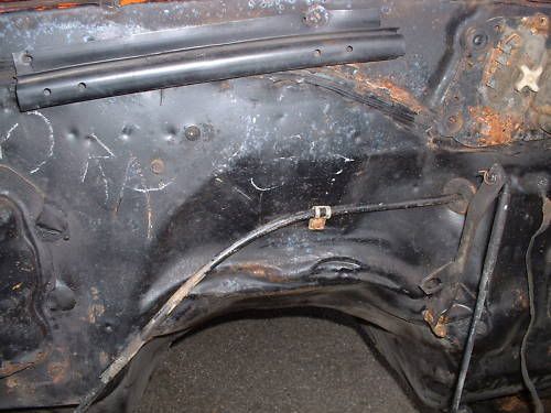

There is no way to prove without any documentation or original parts. And anyone can write on the firewall what they want. This car has been on ebay a few times before. A great fishing expedition!!!!!!!! If he is lucky, he might get a sucker on the line.

What a creative chalk board on the firewall!!
