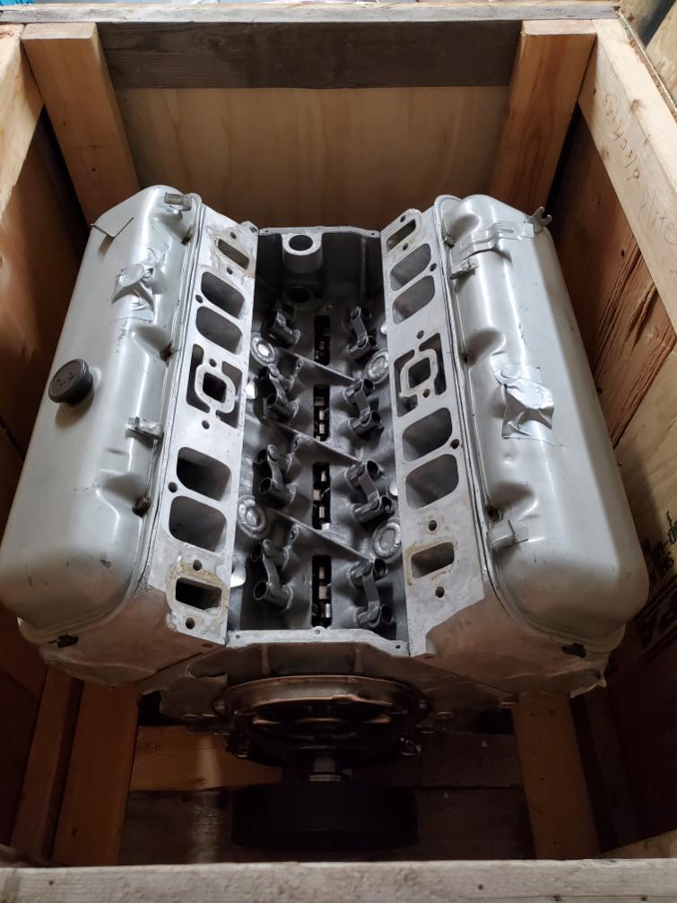

My friend has a complete disassembled '73 Can Am engine, aluminium bores, no mech. fuel pump provision. I can take pictures of any particular details if anybody wanted them.

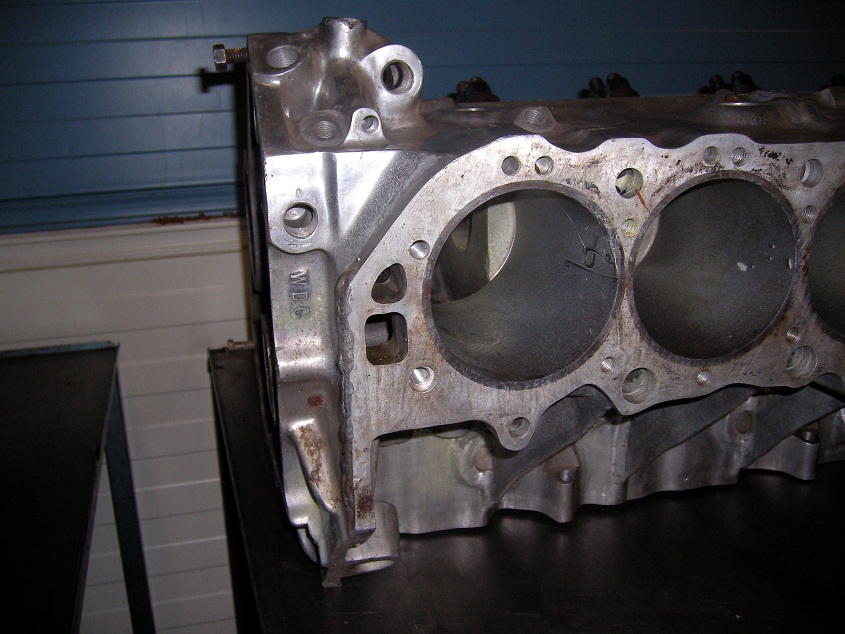

I have had 2 big bore blocks and both were 052 casting and externally identical to a 4.25 block.
