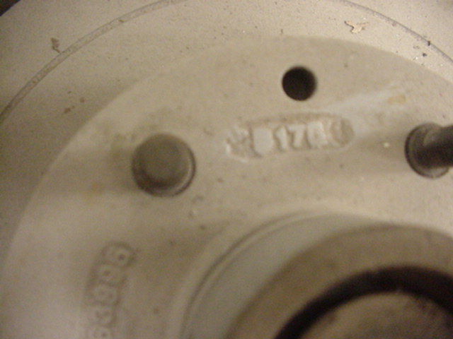

The two I took off my 70 camaro casting #s are Left # is 5470126 & r # is 5470125. I don't think these are org to the car. The disk hub is dated B 14 70. My car didn't have front brakes when it was ran back then.

I still think they are 54 not 64, enclosed pic. 5470126
