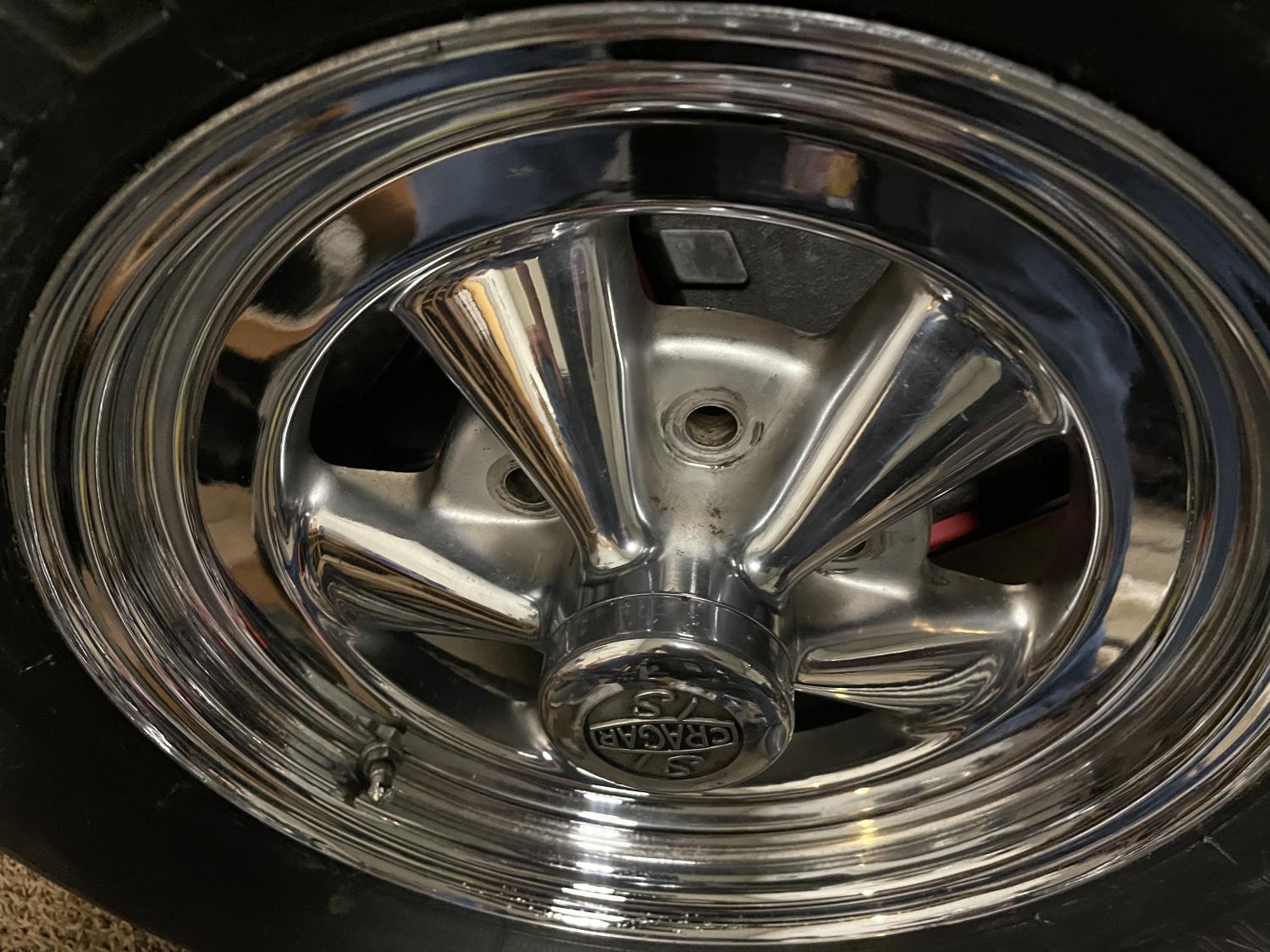

Anyone bought the direct drill 15x4.5 they are still
Made do they have the wide band around then. Do they have the round spike in time yes but have not seen them myself
As for rechroming 15x4 anyone done. One lately? Pricing?
Any ideas on keeping them from rusting?
I’ve lalways heard to polish them using aluminum foil.
If anyone has one 15 x4 let me know I have one starting to get slight pits and since my car was a race car I need to keep it looking as it did.

Who knows. Just know while mine are fairly nice they won’t last forever. I try but you know how that goes Mother Nature is trying to break down everything all the time even US .
If anyone has thoughts on how to keep them from getting worse please let me know.
Thought about using this clear in that area just to keep them free of moisture of any kind . Thoughts?

As far as cleaning, WD40 works great. I use a scotch pad that will then be discarded.
