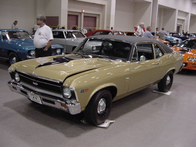

That was the general rule, but exceptions have been noted... One in particular that comes to mind is Joey Swezey's gold 69 Dana Nova. Might have just been a supply issue, ie: no wheels in the correct body color as the car was coming down the line, so they ended up with black ones instead. Just a guess.

[quote... One in particular that comes to mind is Joey Swezey's gold 69 Dana Nova. Might have just been a supply issue, ie: no wheels in the correct body color as the car was coming down the line, so they ended up with black ones instead. Just a guess.
This car? One of the finest looking Novas I've ever seen.
Yes that car, and yes, it's probably one of the most properly/accurately restored 69 Novas I can think of... when it's not sporting it's Day 2 look it wears black steelies and dog dishers on redlines, which is how it was delivered with when new... and looks just as bad-assed as it does with the Cragars IMO.
