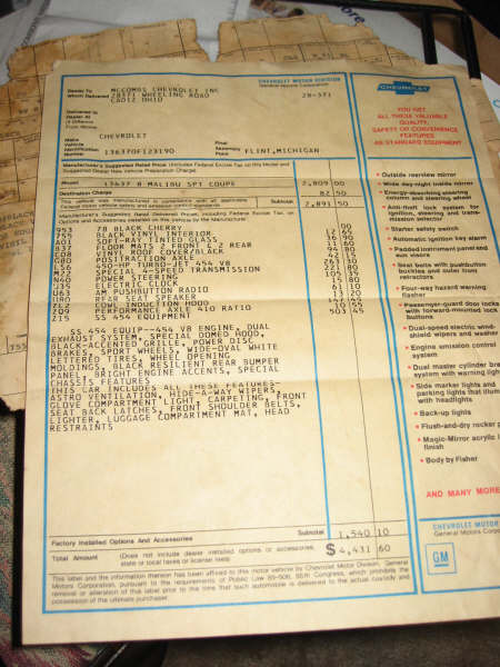

The attached build sheet was sent to me as documentation for a car I was considering. I think its fake.
The all important upper RH corner is missing but the owner claims the 3 boxes above box 109 which are labeled "trim", "paint", "vehicle ident" have the info which belongs in boxes 9, 43 and 44. There are so many things wrong with this build sheet but I want to get your opinions. Also wanted to post this so everybody is aware and can stay clear of this car.

That looks like someone tried awfully hard to make it look old!!
fake aged sheets

Holy geez...before he types up any more Ebay ads that dude needs to jump over to Google and do a search for "spell checker"...
Rob, you're not talking about these two lines...are ya?
Unlike window stickers offered on the internet today...our window stickers are NOT generated with a LAZAR PRINTER. A great deal of TIME and patients goes into every window sticker created

Bingo...

ZL-2 after C0-8?
So many Red Flags here.Flint was Funky,not Drunk.
Run....

Dealer charged to:
Rael Chevrolet Inc.
123 Rue de Clone
Outer Crab Nebula 00000

Looks like a window sticker in the background. Did he offer that up as an iron clad original doc as well.
