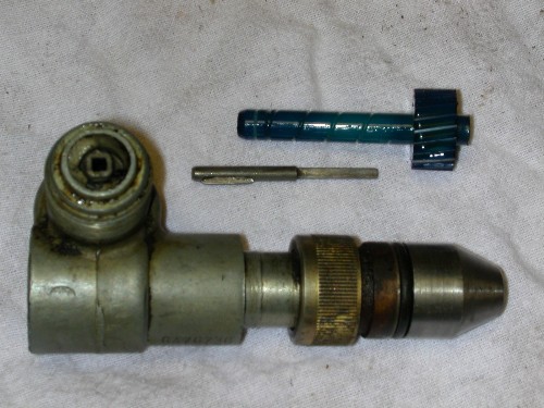

Did the COPO Chevelles use these??
http://cgi.ebay.com/ebaymotors/ws/eBayIS...A%3AIT&rd=1
If so I need to get one...part # ??? Thanks

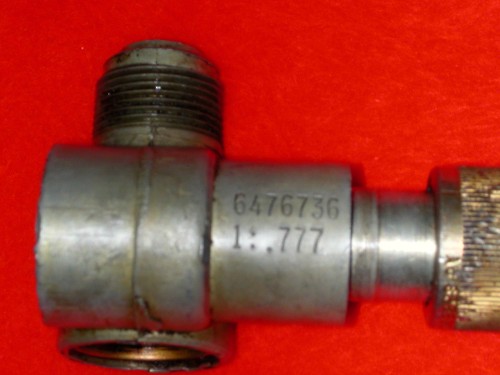

Ed, thanks for the link..OK, I have read the threads and guess I need this one??
4.10 Rear Axle, 7.35x14 or F70-14 Tires, 8 tooth Drive Gear (P/N 3924098), 20 tooth Driven Gear (P/N 3860343), 3 Speed (exec O/D), HD 3 Speed, Powerglide or 4 Speed Transmission. Adapter P/N 6476736.
Did I choose wisely??

Well, almost. You have a 69 Chevelle and it's a bit different on a few ratios than the Camaro! For a 4.10 rear end with F70x14 tires and a 3 or 4 speed manual transmission, you'll need the following:
3924098 8 tooth drive gear
3860342 19 tooth driven gear (neutral color)
3932220 Adapter
I didn't see your reference to the COPO Chevelle above. Sorry about that!
And by the way, GM didn't use a Stewart Warner reducer. That's an aftermarket item.
Ed..I've never seen anything but a Stewart Warner brand used on the Ass.line for this item.Both on survivor vehicles and in the manuals.
Can you show paper or pix to contradict this?
Old 12-23-2005, 10:16 PM
camarojoe's Avatar
Join Date: Sep 2003
Posts: 5,306
Thanks: 238
Thanked 269 Times in 120 Posts
Default Re: speedo reduction box
I have several that only have an AC logo on them with no SW wording. They are the 90 degree type.
Joe Barr
Old 12-23-2005, 10:59 PM
Posts: 10,322
Thanks: 3,146
Thanked 4,567 Times in 1,138 Posts
Only speaking of the 4:10 equipped Chevelles, the Stewart Warner gear is the only one I have ever seen on all the original cars as well. On a side note, I recently had a neighbor ask for help taking a 305 and Turbo 350 out of a 80's something Buick wagon and that also had this exact same reducer on it.
