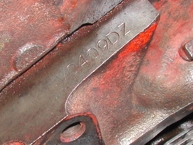

What is the consensus on this stamp? I have an opinion but before I let the owner know what I think I'd appreciate your feedback.

Compared to several known originals, it is an obvious re-stamp.

No gang stamp on that one, I think the "4" is off too.
Here is the stamp from my old survivor 69 Z:

Almost looks like it's raised embossed...LOL

Fonts are all wrong and appears hand stamped as said above.

Yep, thats a bad one
