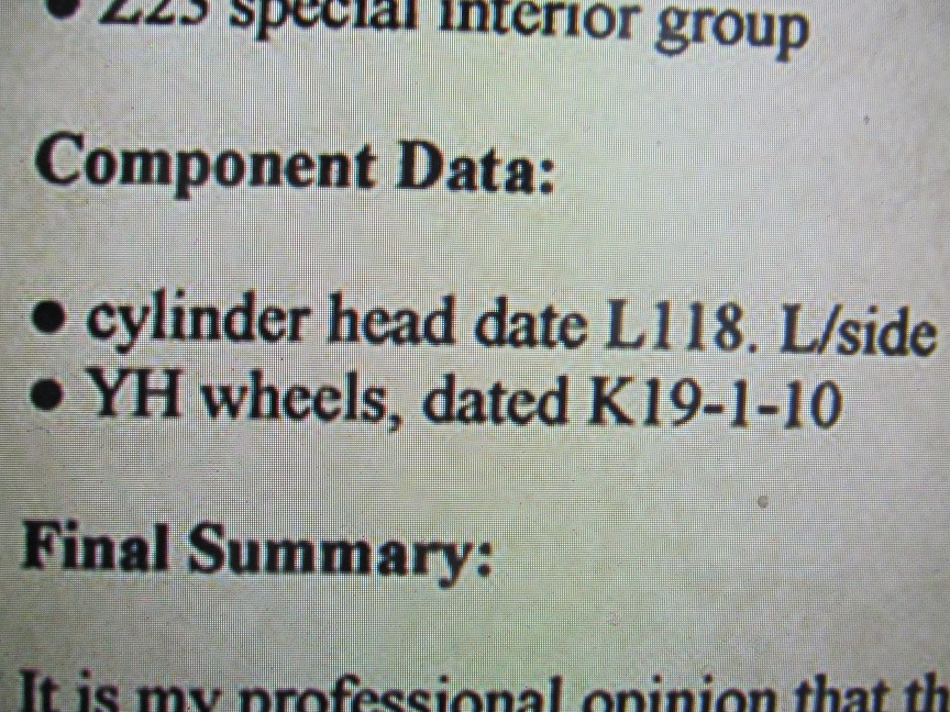

A former colleague of mine is looking at this car. This would be his first serious collector car so I offered to help him dig up any history you guys might have with the car. Any feedback would be great...thanks!!
(I told him if he gets the car, I will align the DS headlight cover for him....)
http://tinyurl.com/j9fpqxf

For all the pics of jerrys reports and #s i would want to see the eng pad stamp without paint and the orig invoice as stated that he had for that kinda $$. Like the others stated very nice piece if u want eye candy thou..

I wouldn't worry about the stripes. I would want to see a pic of the bare engine pad though. Was restored by a member here so maybe he can comment ?
