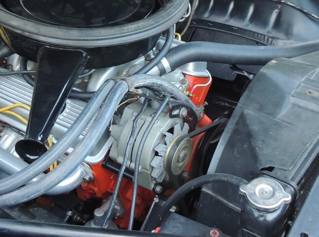

[img]https://www.yenko.net/ubbthreads/pics...riginal_z28_en[/img]
Here is a pic from way back when, note the Timing sticker on the fan shroud, would this be factory original location, or has it been replaced ??

Mike: Most were on the core support. But, that pic you posted is not the only Z to get the sticker on the fan shroud. Fan shroud was the &quot;correct&quot; location for A/C cars because of the rubber seal on the core support. My guess would be that some of the line workers, after placing several on the fan shrouds of A/C cars just put one on a non A/C car from time to time.
