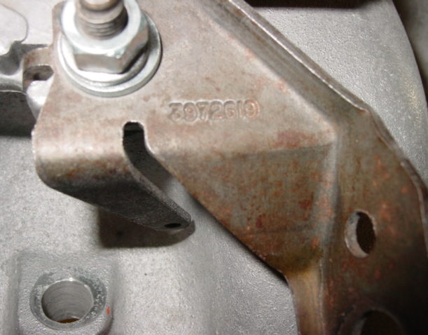

Old 07-15-2008, 06:47 AM
P.J. P.J. is offline
Join Date: May 2004
Location: Ontario Canada
Posts: 1,320
Default Re: Question about throttle cable bracket finish????
I have also seen one that looked like rust colour just like the previous one. The pic is courtesy of Chris.
PJ
