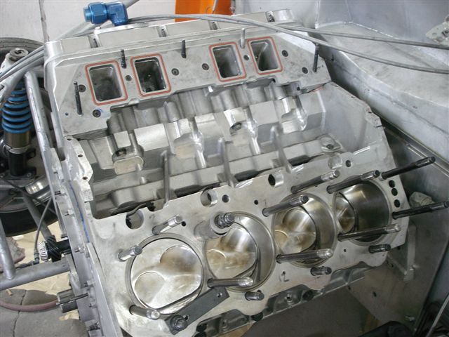

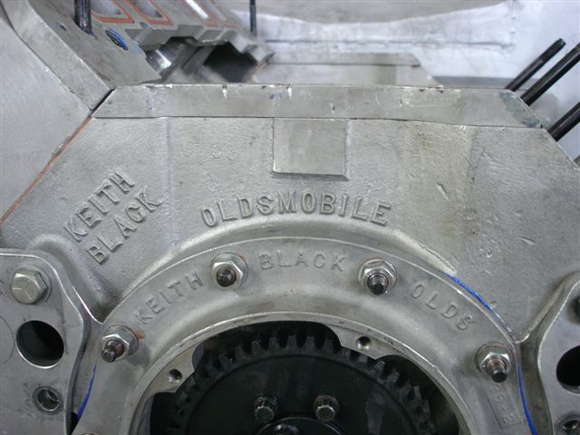

Hi !
I picked up an aluminum block with some damage today. I don´t really know if it can be used on the street, but my first thought was to use it in a friends Olds 442. He is running a blower on his original engine, and I think this Keith Black-block is better suited to take that power. I would hate to see him destroy his original block.
Now does anyone have any experience with this type of block from K.B. ? I was told by my friend who had it that it has the Chevy BB head-boltpattern and that it accepts a Chevy BB crank, but it´s taller than a talldeck Chevy BB. The waterpump-pattern is also Chevy BB so it has ofcourse waterjackets.
Would it be crazy to try to use it on the street ?
Anders Stålklint.

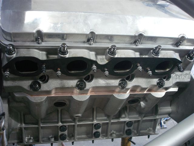

Old 05-18-2008, 11:32 PM
Join Date: Sep 2002
Location: Anderstorp, SWEDEN
Posts: 1,650
Thanked 16 Times in 14 Posts
Default Re: Chevy/Olds aluminum block
Sidewiew of block.
Anders Stålklint.

Thanks Sam !
I don´t remember the deckheight but the bore is 4.400 inches.
A yenko aluminum block can be used to build a street-engine but is this K.B. Oldsmobile-block just to much of a racepiece to be used on the street ?
Anders Stålklint.
Old 05-21-2008, 12:32 AM
Chevy454 Chevy454 is offline
Join Date: Mar 2000
Location: Alton, MO, USA
Posts: 11,923
Thanked 8 Times in 8 Posts
Could be used on the street, no problem...it'll only be as racey as you build it! LOL!! Only issues I can think of are if it's a tall block, then you'll need special headers, intake (or spacers), distributor...everything else sounds standard fare big block stuff. With that block, you could easily go big bore/stroke (550"-600" I'd say), but keep the compression down to pump gas levels, and have a thumper of a street engine...

Old 05-23-2008, 06:33 PM
markjohnson's Avatar
Join Date: Dec 2003
Location: STL, MO.
Posts: 2,502
Thanks: 269
Thanked 627 Times in 246 Posts
That looks like a dry block to me and not very streetable. I think these things are super exotic and there's a reason that you don't see them used in fast street cars. Do some more research.
Old 05-23-2008, 06:52 PM
Join Date: Mar 2000
Posts: 11,923
You know what, you may be right, Mark! In the first picture, there are holes for the water pump flow, though, but none on the deck faces of the block? Maybe it's for use with dry heads, and just circulates coolant in the block itself somehow? Wierd...
Old 05-24-2008, 04:24 PM
Join Date: Sep 2002
Posts: 1,650
Yes that´s weird. I think I´ll contact the Keith Black company and ask them of their opinion.
I spoke to a guy a couple of years ago, who used an aluminum K.B. Hemi raceblock on the street. He told me that it worked if you knew which measures to take.
Anders Stålklint.
Old 05-27-2008, 01:00 AM
Posts: 1,628
Thanked 2 Times in 1 Post
<font color="blue">If I'm not mistaken I think you must plumb the water to the heads seperatly.
"Don't quote me", I remember seeing a blown one at the track with a few water lines off the top. </font>
