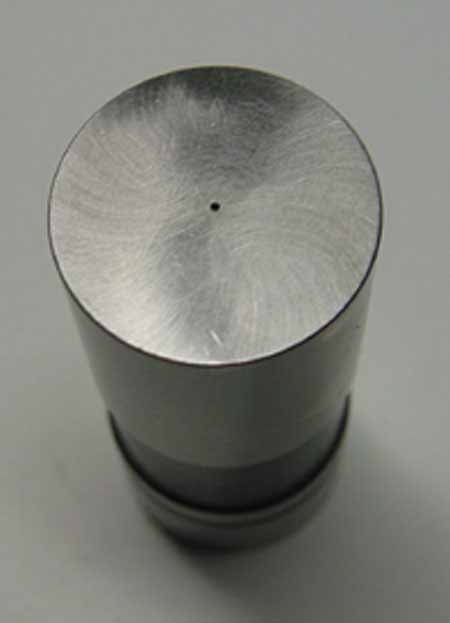

Hello, looking to relpace a GM cam with either a NOS L88 or ZL-1 cam or a after market. Does anyone know which after market cam best meets the specs of the GM one. I have a crate L88 that was just fired and the cam went flat. Used the Rotella oil and all precautions but it still went flat on one lobe. Thanks, Larry.

I would strongly recommend using a set of lifters with an EDM bleed hole for added insurance next time around.
Also be sure to remove the inner valve springs and break the cam in on the outers only.

Hello, I used a set of the lifters you mentioned. There about 170 bucks. I am looking at the Crane cam thats mentioned. Larry.
