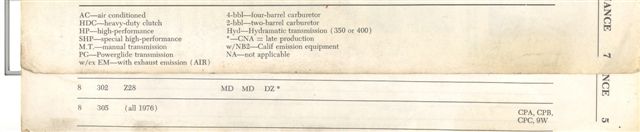

My friend Hans showed me his midseventies Chilton´s Camaro 1967-76 repair & tune-up guide a couple of days ago. He pointed to the * next to the DZ enginecode, and the explanation *-CNA=late production.
Has there ever surfaced a 302 with the CNA code ? Was it mabye ment to be, but never happened ?

Isn't CNA the '70 Z-28 350 stick?.
On a similar theme, anyone know if there were Suffixes stamped on Marine issue 302's other than the 67-68-69 car ones?.
