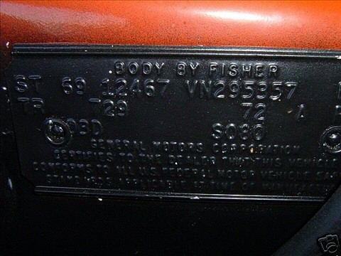

Ran across this item this morning. Anyone else seen it?
http://cgi.ebay.com/ebaymotors/1969-CAMA...1QQcmdZViewItem
Anyone know anything about this one? Seems to have carefully chosen the wording as well as some things clearly missing for a "top dollar restoration".
Attachments - The Supercar Registry 253869-Ztag.JPG 253855-253726-trimtag.jpg 253726-trimtag.jpg

Thats the one with the fake tag. I know it has been discussed either here or camaros.net.

-----A couple of questions from a guy who is still learning a bit. Shouldnt the rockers be painted black below the rocker trim on this car??? Could a convertible other than a pace car be delivered with houndstooth deluxe interior???......Bill S

Good questions Bill... shouldn't it also have a blacked out rear tail panel? Or was that coupes only?

Not only a fake tag, but won't post or send pics of deck stamp or VIN derivative stamps on engine and trans. What else is fake?
Black out info here:
http://www.camaros.org/exterior.shtml#BlackoutPaint
As far as the black outs, that would be easy enough to fix, but as far as I am concerned, once you put a fake tag on the thing, may as well paint it paisley.

Here's the tag info from what I can see with the numbers/letters. The positioning of the numbers/letters is interesting. I have attached a copy of the pic.
ST 69 12467 VN295357
TR 729 72 1 (or maybe a 4)
03D S080

-----Why is the left side rivet located where it is???.......Bill S
