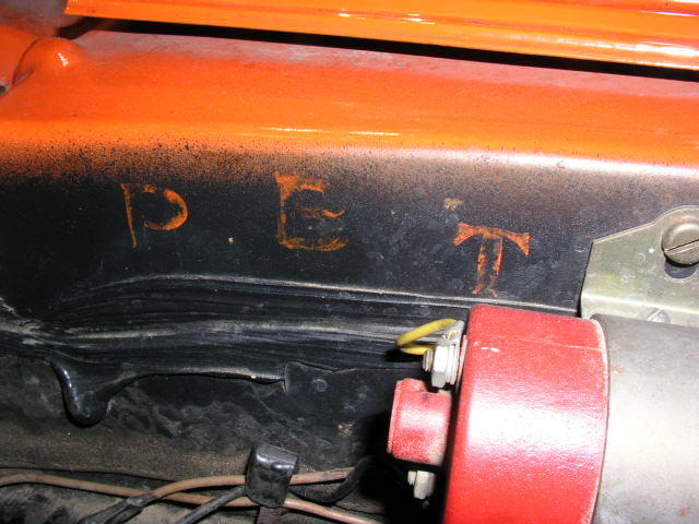

The top of the cowl should be orange. The orange fogs over the top edge of the firewall, overspraying the black firewall paint on Norwood cars, and has a taped edge on LA cars.

Here is the top of the firewall on Barnharts ZL1
