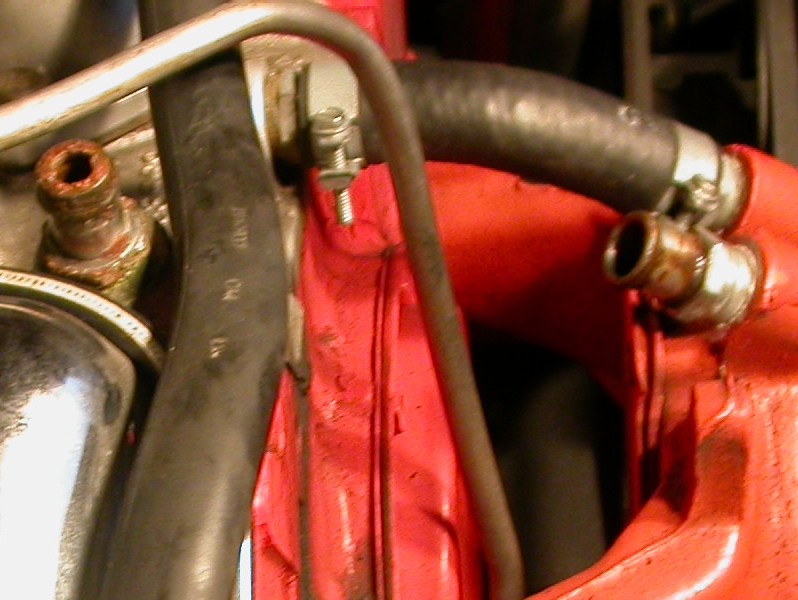

Where can I get the correct hose adapters to screw into the water pump and intake manifold for the heater hoses? Mine are a little skanky and I'd like to replace them with new...

I like PSST stainless fittings, not correct, but correct looking and they do not look like crap a week after installing new ones, that are zinc plated JUNK. I have had some old ones cad plated, and they are ok.
Here is a link http://performancesst.com/customer/p...=13&page=1
Ricks and Summit carry them too

Good luck getting the old ones out if they've been in there awhile... sometimes they can be really stubborn, especially in an aluminum intake.

Heat and a prayer for that intake unless some kind soul previously put teflon on the threads.

Lucky me, previous guy knew how to use teflon tape, I got them out tapping the big adjustable wrench with a BFH.
