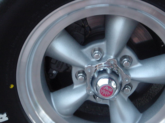

Does anyone have any recommendations for painting the centers of the TT D wheels such as type of paint, methods, etc.?

How about just making them correct as per the originals: bare cast (glassbead works that crappy paint off) and send them out to high polish the outer rim (getting rid of the machining rings). That is the right look, just did a set and they are killer. I called American a few years back and they wanted to argue with me that all Torque Thrusts including T70's were painted battleship gray spokes originally. I purchased my first new set in 1971. The man arguing with me was born in 1974. Case Closed.

Glass doesn't look quite right...the outer lips were not high polished but rather machined finish. You can mak the new repop wheels look a ton better by simply getting rid of the grey spokes by using Alumi-Blast or some other Aluminum replicaction paint ...

Here's a set of the newer 15x6 TT's with the center sections lighted with Eastwood argent silver lacquer. While they looked a ton better than out of the box gray, I have since replaced them with a true set of vintage straight spoke mags, finished similarly. The "left natural" idea sounds good in theory, but if you ever plan to actually drive the car or hit the brakes, the dust will quickly make them look like hell, and nearly impossible to clean.

Let me clarify: I only suggest the glass bead to remove the crappy gray paint, not change the cast finish. It's there and it's fine; it just needs uncovered and the bead blasting has done that just fine for me on numerous new wheels. Original old wheels were not high polished outers but did NOT have that heavy machined ring thing going on either. Smoothing and polishing now is the only way to get the outers back to smooth and they lose the fresh polish look quickly if you wish to get as close as I have found to what they did late sixties, early seventies. Yes, brake dust is an issue. Aluma-Blast is OK, probably the best finish if you dont want to leave them bare as they were originally. Better idea than a clear in my opinion.
