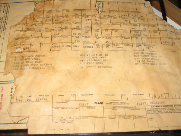

The attached build sheet was sent to me as documentation for a car I was considering. I think its fake.
The all important upper RH corner is missing but the owner claims the 3 boxes above box 109 which are labeled "trim", "paint", "vehicle ident" have the info which belongs in boxes 9, 43 and 44. There are so many things wrong with this build sheet but I want to get your opinions. Also wanted to post this so everybody is aware and can stay clear of this car.

That looks like someone tried awfully hard to make it look old!!

ZL-2 after C0-8?
So many Red Flags here.Flint was Funky,not Drunk.
Run....

Dealer charged to:
Rael Chevrolet Inc.
123 Rue de Clone
Outer Crab Nebula 00000

Looks like a window sticker in the background. Did he offer that up as an iron clad original doc as well.

I'll bet SS427 Rick would give an opinion. A buildsheet means nothing without the VIN. I say

I try very hard to keep my opinions to myself unless they are positive. That being said, that is not even good for an amateur. Don't walk, RUN!
I don't necessarily turn a car away if the VIN is missing as there are some other tell tale ways of checking to see if it matches the car if some other numbers are present. However, this sheet is very inacurate in my opinion. I would rather deal on a car with no sheet versus one with a fake sheet.

Poor replica of a build sheet. If the link above is to the car, it's only about five miles from my house.
