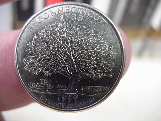

I have two Sony Mavicas with floppy slots and the flower setting. I can take pictures of Holley carb numbers an inch away. You have to push the button half the way down and let the camera refocus before you snap the picture. Here's a picture of a quarter from 1/2 inch away.
