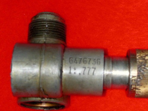

Al, This is the original one on my 69 L78 Camaro with M-21 and 4.10 gears.

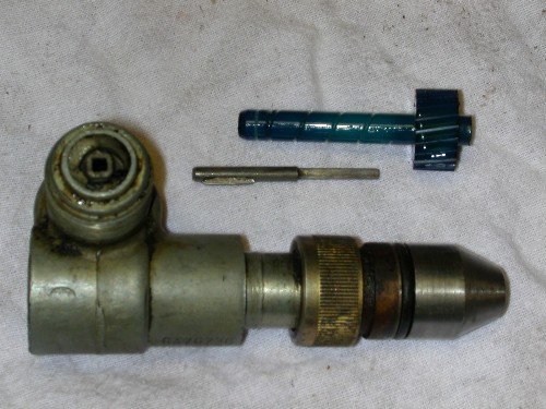

Is there a pin or key that goes from the reduction unit to the speedo gear? I still can't get mine to work properly

I have the Damn pin, (technically a 'key') but something still aint jivin

Marlin, Attached is pic of the key that goes inside the gear and reduction unit, it is 1 13/16" long. If you can't get it working, just sell me the damn old Nova.
