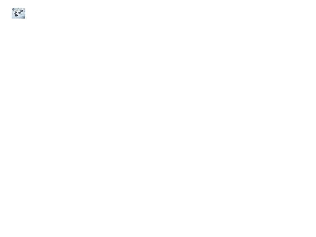

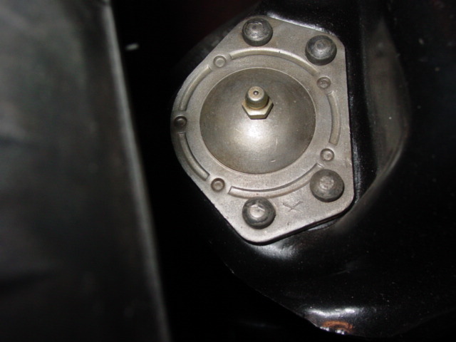

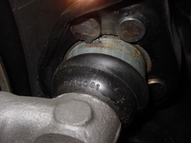

Not to step on anyone's toes, but the right rivits are flat head and I've never seen anyone supply the right ones. I'll attach a few photos.
Chevrolet used flat head rivits, installed from the bottom. The "oval" head you see on the top is the result of the rivit set used in riviting. I happen to have a large selection of rivits, so it is not a problem for me to make them right. In NOS ball joints with the large 5/16" hole, I use a 5/16" (as opposed to the orig 1/4") flat head rivit and turn the flat head down to the OD of the 1/4" rivit's head on a lathe. I made a rivit set and hot bucked them in place - it helps to have an extra set of hands here.
Note that the "oval" head in the photos is irregular - not at all like an oval head rivit. That irregularity is a result of the rivit set (the tool that forms the head).
You just can't make 'em look right with the wrong rivits!

Original rivits from the top....
