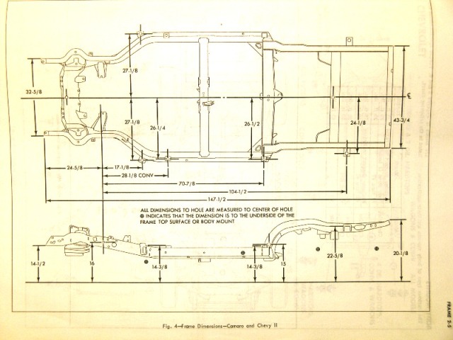

I'm new poster long time reader. There are some very knowledgable people in here so i thought I would ask this question here. My friend has a 68 Nova thats a drag car. About 2 year ago it went on the back bumper and came down pretty hard. It had to have the frame straighten and everything was ok for a little while. Well the frame is moving again. What i need to know is, Does anyone know the measurement between the front shocks? Maybe someone out there is in a middle of a resto and can measure this for us.

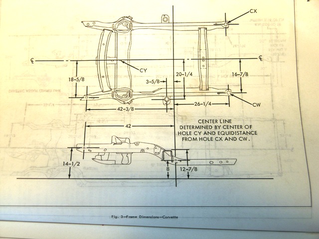

Not sure if this will help or not. Got this from the 1968 Chassis Service Manual

Uhhh ...never saw a Camaro/Nova subframe that looked like that diagrahm Looks more like a Corvette.

John, Never noticed that it shows a full solid frame and was labeled for Camaro and Chevy II. This one shows the Front Sub Frame but it says its for the Corvettes, go figure!!!
