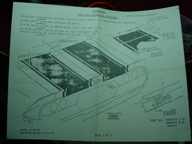

The three piece spoiler used a Pontiac center with (originally) special made end pieces to match the Camaro fenders. I have a dated GM drawing, as I remember January 70. Will check it to be sure.

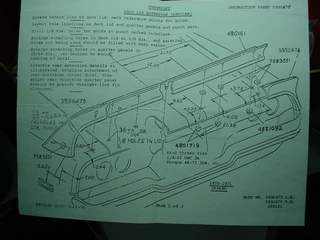

Dug the three piece spoiler instruction sheet from the archives. Dated June 70.

I'll try again. Picture # 1

Picture # 2

This site is a treasure trove of info
