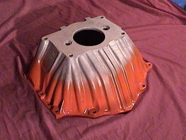

Here's a shot of a restored hsg....I just copied what was there.....

Thanks..just what I needed..I assume the bolts get painted as well? as if it were mounted on the block? thanks alot.

Yep,bolts and all.That's why the hsg was painted.It was in line of fire of the spray gun.

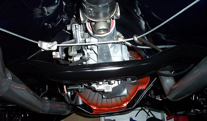

Well, as long as you are looking at examples...Albert this is my 66 SS....

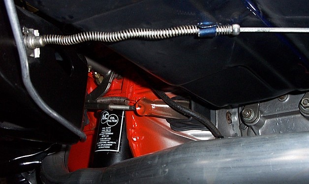

Default Re: Bell housing color
and
another
