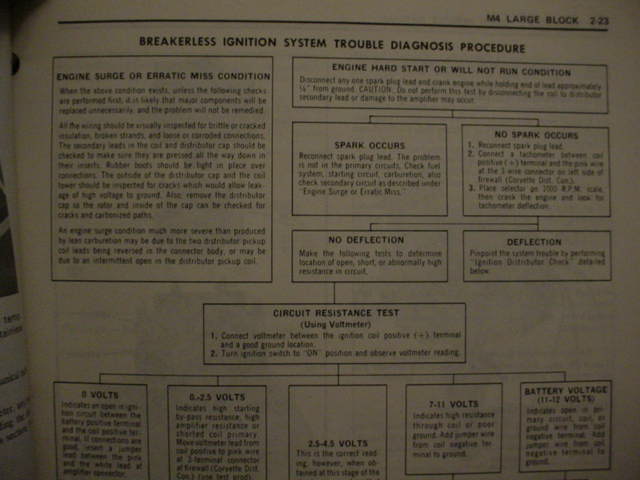

After 5 yrs. of faithful service, the transistor ignition system on my 71 LS6 needs attention. I know where I can find parts, but what about wiring diagrams? If the problem is a short or a worn out connection, an accurate diagram would sure be handy.
