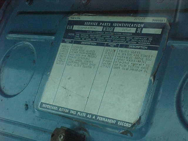

What do you guys think about this car?
http://cgi.ebay.com/ebaymotors/ws/eBayIS...TRK%3AMEWA%3AIT
Attachments - The Supercar Registry 121063-glovebox1.jpg 121062-Fr400emblem.jpg 121059-Cheyenne.JPG

That is the first time I have ever heard/seen a SS "400". The broadcast sheet also states that fact and matches the air cleaner decal.
Is that legit?
Dave

Yeah, I can't say I've seen an SS with the 400 designation before. It's not even a 400, it's a 402. Very interesting. Nice looking car too.

so is this car correct

I have seen that before on other Chevelles. It had something to do with the way the option was marketed. Some repair manuals will show a 400 w/2bbl and 400 w/4bbl. The 2bbl.was a small block. The 4bbl. was a big block.

THE BUILDSHEET FOR THE CAR CONFIRMS ITS A 400 CI. KP

So does that mean it should have a small block 400, not a 402 big block?

LS3 ON THE BUILDSHEET IS A BIG BLOCK... KP

So is it really a 402 big block even though they advertise it as a 400? I've never heard of a 400 big block, just the 396, 402, 427, 454.
