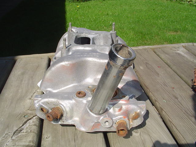

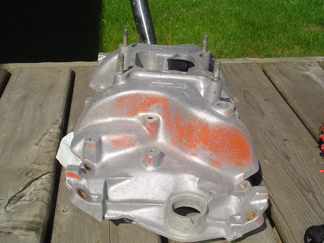

valve covers, water pump, intake, exhaust manifolds, etc. were installed prior to engine painting, and the top of the engine was masked using a cardboard cover, allowing an "edge" of overspray on the chrome valve covers. The bypass hose on the waterpump was also installed prior to painting, and often had a little to alot of overspray on it. I've seen iron intake cars with this hose completely painted orange from the factory.

I do not think that I have ever seen the valve cover overspray ever duplicated on a restored car.
The bypass hose, exhaust manifolds, and aluminum intake most of the time are oversprayed on restored cars but not the valve covers and gaskets.

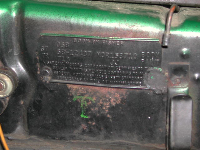

It is very faint on the car now in that location ...but the cowl is also marked with the PBT behind the brake booster (unlike the passenger side it escaped someones black buzz-bomb detailing job!)
See attached picture...Hows that for a trim tag rivet!!

Its always cool to see an original unrestored firewall/ engine bay... Also notice how the green overspray is just fogged over the edge and onto the trim tag itself, with lots of seam sealer slathered everywhere... cool pic!

full shot of trim tag, and a stray T.
