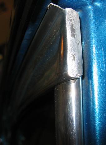

Old 06-18-2004, 06:19 AM

Default Re: 70 Nova Side Window Bright Trim Questions
Bill, I took a few "close up" shots of mine. Again, the Nova system may be a little different. Hope they help.
Here is "front top of door".

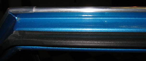

here is "back top of door".

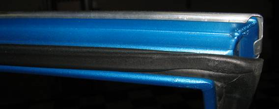

Here is "front top of quarter glass"
