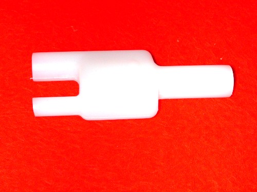

Does this look anything like the original, this is a repop from Ground Up?

Yes,that is almost Identical to mine here.
I'll send you a jpeg via email.

Looks pretty decent. Other than being nice and white looks like a original

Thanks guys, it's actually not that white, I edited the pic to brighten it up. Any ideas on where I can get a restrictor for on the top?
I used a axle tube vent still available from GM. Fits right into the top of the surge vent. Allows venting and keeps dirt out.

Actually, The restrictor for the top is nothing more than a piece of foam...similar to lawn mower filter material. A friend found a NOS one years ago...thats all it was foam...about 3/8" x 1/2". I put a piece in mine, and have had NO problems in 2 years...no leak, no fumes, no fuel tank collapse...Just my experience

I have two originals here that I took off of cars in the 80's.They are yellowed,but useable.They used to have a foam element inside,with a cap on it as well.
