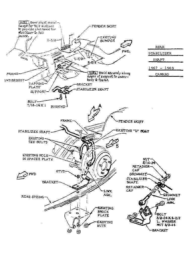

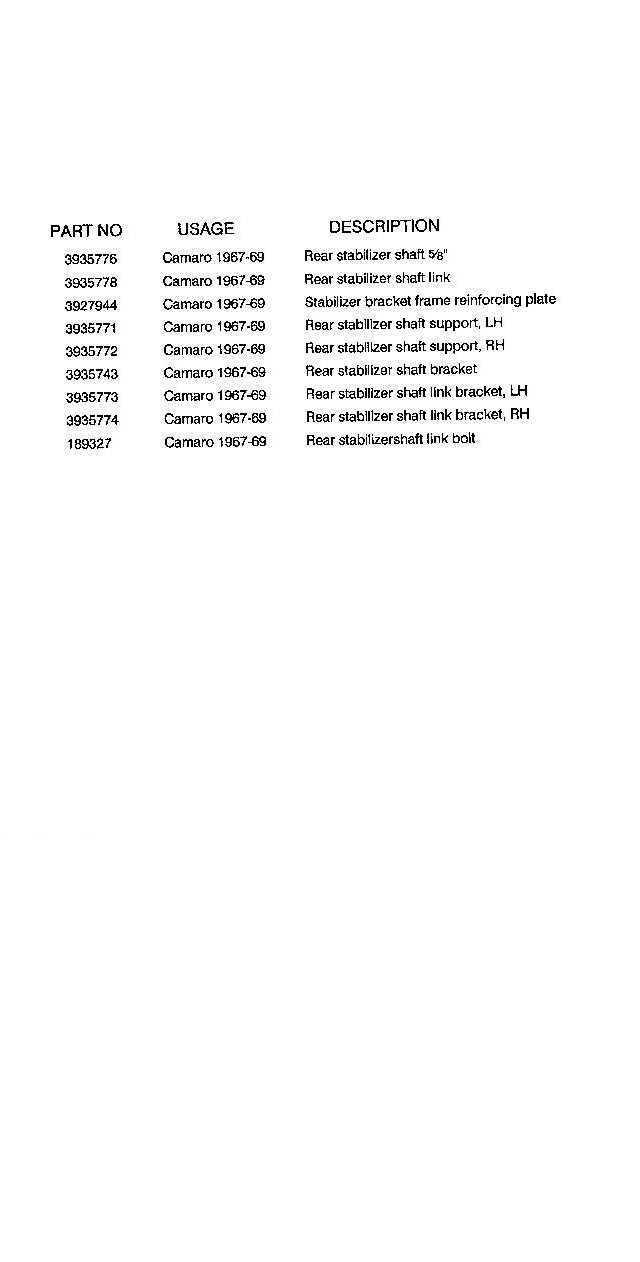

The '67 Z I have been attempting to buy (looks like the deal has gone cold AGAIN thanks to an IRS paranoid owner) has a rear sway bar on it. It does not appear to be the same as the GM units that I have seen in a few books. Was anyone else making rear sway bar units for these cars? The bar itself bends around the pumpkin not like the straighter GM bars. Thanks in advance,
