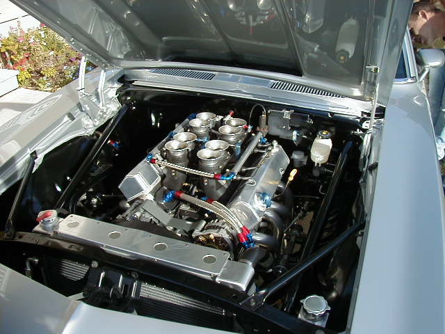

I want to put an individual runner EFI fuel injection sysrem on my 396 powered 67 Chevy II. Been looking at Kinsler and Hilborn. Any thoughts would be appreciated.

How much do you plan on driving it on the street? Those are not great street setups. How will you start it in cold weather? Stand outside and squirt gas in it?
I would say forget it for eveyday use. Sure look good though. Lucas makes a smooth running one too. Mostly used on Can Am race cars. It could be used on the street in a pinch but still would not be what you think would be the trick setup. If you could go to the floor at every stoplight you would not have much problems with them but traffic would not be pretty.
I would recomend a factory street setup for reliability and mid-range driveability.

He is talking Electronic EFI, not mechanical. My Silver 69 has the Kinsler and works fine on the street. We drove it on Power Tour last year. I had spoken with someone that put the Hilborn EFI on a Cobra with Hilborns computer and they had a bunch of problems till they figured out they had a defective Computer. Now he likes it.

It has been my experience that the Hilborn EFI is a great choice for old school engine tuners who like to tune with a srew driver. The Hilborn ECM actually has electrical "pots" which are adjusted with a screwdriver.
Most other control systems require more complicated computer interfaces that the average builder is not capable of learning quickly. These also cost a whole heck of a lot more, but offer better drivability when tuned properly. I'm not so sure you'll need to improve the drivability, unless you are trying to make the car drive like a Lexus.
The bottom line is the Hilborn is an economical controller that does the job better than a carburator or mechanical injection. I was able to tune one pretty well just by going by the seat of the pants feel. It probably could be done better on the dyno- but this was close enought for the girls we go out with.
