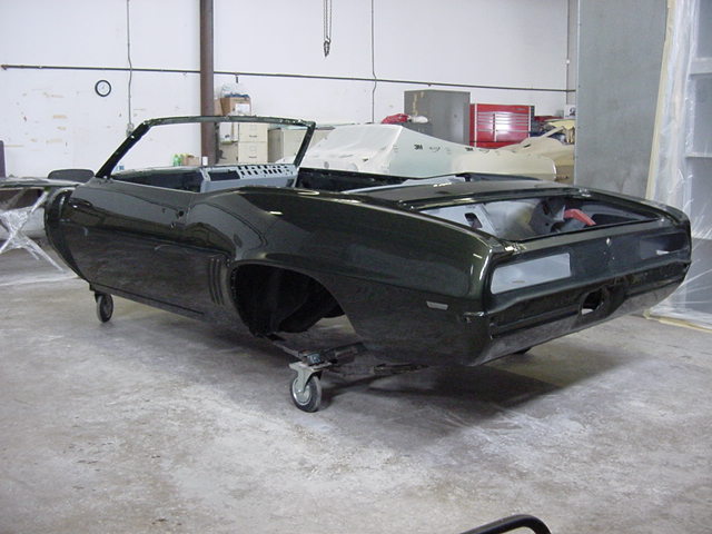

I want to thank everyone who responded to my question about Fathom green paint mix.
The car is now Fathom Green and starting on the road to completion.
Attached is a picture of my Green Machine!!!
1969 Camaro L-89 Convertible

You are welcome Robert and remember that's what we are here for, to help each other out. Your 69 looks sweet so far!

Looking good. I've looked at your car every time I stop by the shop to check on my JL8. I hope to see the Hugger Orange on my car pretty soon as well.

Nice car! That is the color. Did you go with PPG? sam

sc69sam, the car is dupont chroma premier base coat w/dupont 7900S clear. Actually the clear was sprayed on with 3 coats then we let it set for a week blocked it out with 1000 grit paper and an additional 3 coats sprayed on. Now it's ready for sanding and polishing.

Robert, I'm glad to help out any way that I can on this site and I know that if I ever need a question answered it will be run by these guys and gals first. Keep up the good work here . By the way, the car looks great and I cant wait to see the final pictures after its back on the road. Keep us posted...
