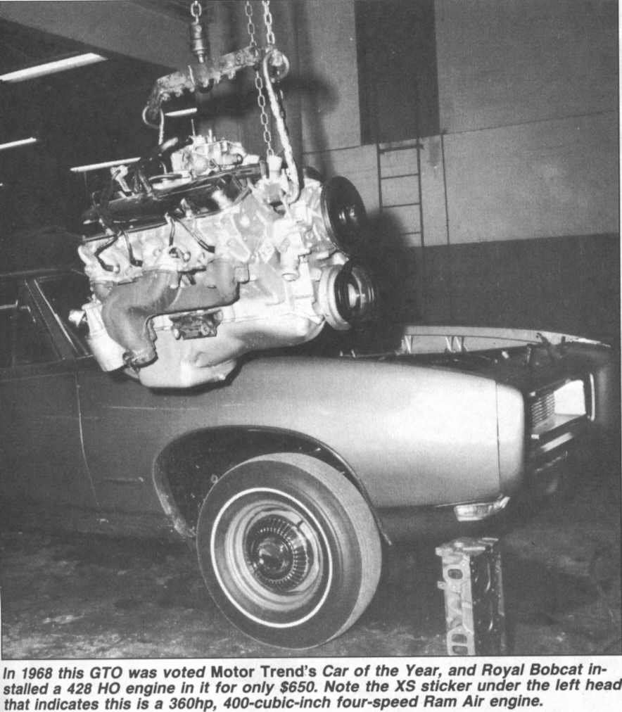

I have seen a 1966 GTO at some car shows and it has a 421 cu. inch engine with the tri power set up on it and the guy claims that it is original. Did they ever put 421's in a GTO and did they ever put the tri power on a 421? [img]/ubbthreads/images/graemlins/dunno.gif[/img]

Thats a pretty loaded question [img]/ubbthreads/images/graemlins/laugh.gif[/img]
The RAV thread is a very long thread trying to prove or disprove that a RAV came from the factory.
I think that the general feeling is that no 421 was ever put in a GTO at the factory.
You could get Ace Wilsons Pontiac to install a 421 in your GTO. Possibly thats what happened with this GTO.
To answer your other question...Yes 421s could come with a tri-power.

the only factory installed 421 "small" cars were the factory 63 421SD cars.

I'm pretty sure Royal Pontiac was doing 421 conversions on GTO's by then... but to the best of my (limited) knowledge there were no factory 66' 421 GTO's made
