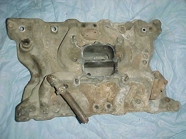

#1. Is a Eldelbrock Marked "SP2P 400" at the front. I thought it was a Pontiac but it just doen't look like one but I am not a expert on them not having to work on many years ago.

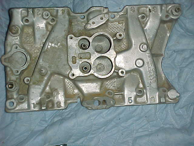

#2. Is a Factory Qjet intake "A 4" cast in large letters top and bottom. also has "CFD 2" and "22504068" on it. It has some kind of 1/2" round port under the center of each front butterfly where the Q-jet goes.

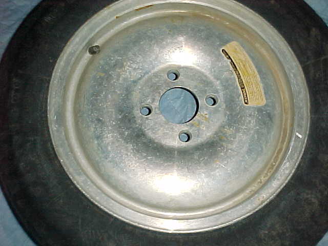

#3. was a 4 lug spun alum 15" light weight wheel that looks like a 4" x 15" drag wheel but is in fact a factory space saver complete with a spacesaver 300 mile tire. there is a set of # that did not get stamped deep enought in the hollow to be read. there is also a #"B9 3209" with the first 9 lower than the rest of the spamping.

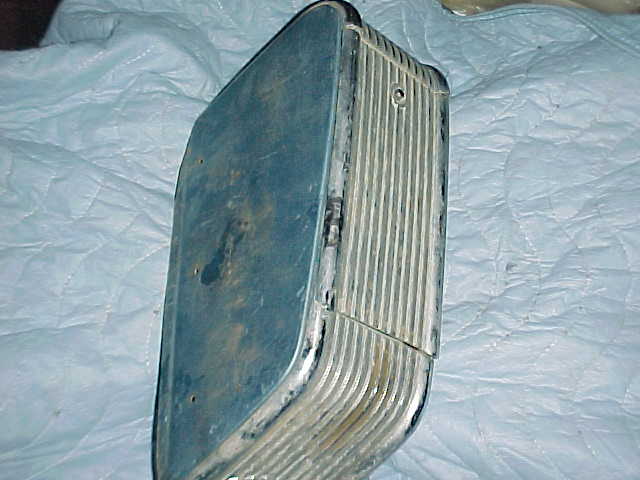

#4. was a ford T-bird? console "1959-60"?

The Edelbrock SP2P is an older style dual plane low rise intake. (Predates "Performer".) There were various versions for Chevy, Ford, Mopar, AMC, etc.

No it is a single 4 barrel divided down the middle.
pic of #1

Larry. Looks like you got you a FORD 351M 400 intake there. Check out the similarities to the newer Performer. Shape.. bolt pattern.... Bend over Larry..Sorry [img]/ubbthreads/images/graemlins/grin.gif[/img]

That is what I was thinking but the guy I got them from said they were Pontiac. I didn't get hurt on it as I didn't give much for it cause it looked pretty bad.

#2 I think this is a Olds intake. It has some big ports like a BB chev.

Yeah, the Second one is a Small block Olds. 260-403. [img]/ubbthreads/images/graemlins/naughty.gif[/img]

#3 Wheel obviously a spare for a late model car

Pic of #4 = Tbird ???? console glove box. Pic looks worse than it actually is. Dirt makes it look bad but it is not that bad and it is all there.
All these are for sale if anybody has a need for them. Otherwise I will post on Ebay in a few days after I clean them up. #1 is caked in dirt.
I just need to know what they fit?
